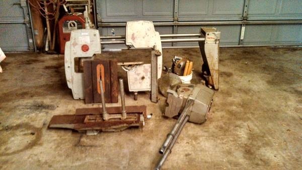

Maybe one here....
Looks like a jointer on the floor with a table on top. I can get it for you if you are interested. My son is at college there. An hour and a half drive for me to get it. Seriously no problem. Let me know. I will take the tubes and casters if you want to buy it.
http://collegestation.craigslist.org/tl ... 59768.html
[ATTACH]23898[/ATTACH]
- image.jpg (68.31 KiB) Viewed 5233 times

Great deal with a bandsaw, belt sander and joiner. No sure it is a 6" joiner as I remember it being quite long. I wish I was closer to pick these up. I believe most of these SPTs used steel in place of aluminum so they are heavy and well built. The way and bench tubes are smaller 1.675" vs 1.75" for the Shopsmith however a Shopsmith headstock will fit and lock down on the TS way tubes. No Shopsmith part will fit inside the TS headstock. This will have steel tables but the miter bar groove is what the table saws uses so you can adapt one of their miter bar to the Shopsmith miter gauge. I was able to fit the TS tables in the Shopsmith carriage and the SPT legs are the same diameter. I still have 2 TS steel main tables, each with a miter bar front extension table laying around if anyone is interested.2centsworth wrote:Looks like a jointer on the floor with a table on top. I can get it for you if you are interested. My son is at college there. An hour and a half drive for me to get it. Seriously no problem. Let me know. I will take the tubes and casters if you want to buy it.

6 inch jointer
How wide is the table sitting on the jointer ? Would that be a good guess as to how big the jointer is ?
