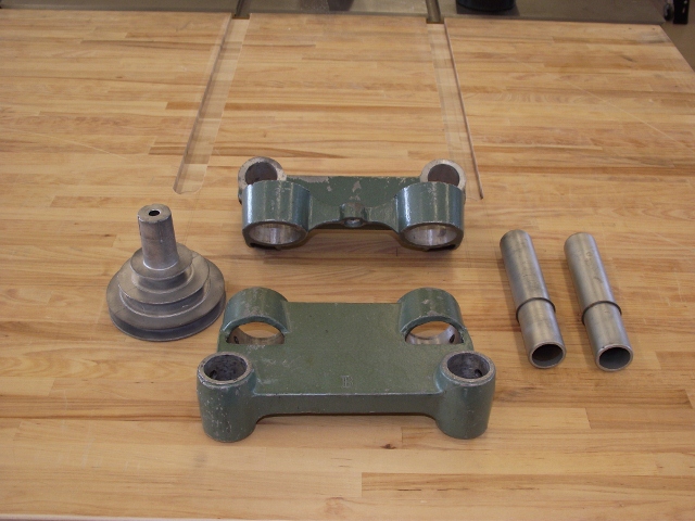

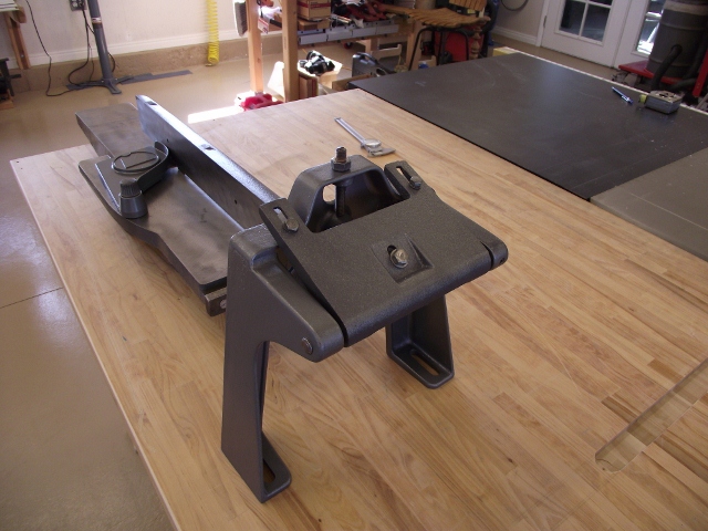

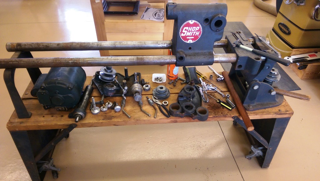

My winter project has been moved from the garage to the shop. Last winter I restored S/N 83974. That restore can be found here.
http://www.shopsmith.com/ss_forum/viewt ... 74#p202325
This winter it is that ones younger brothers (S/N 83973) turn. This one has an AO Smith 3/4HP motor. 83974 has an AO Smith 1/2HP motor. So far the only problem with disassembly is I can not get the head stock pulley off of the drive sleeve. It has had two applications of Kroil and sat for a week. It will not move. Next attempt I will use a torch to heat up the pulley. The pulley is damaged so I may have to figure out a way to cut it off. I do have a spare pulley but if heat does not work I might need a drive sleeve and spacer.
- IMAG0574.jpg (197.8 KiB) Viewed 6242 times
- IMAG0575.jpg (200.27 KiB) Viewed 6242 times
- IMAG0576.jpg (200.39 KiB) Viewed 6242 times

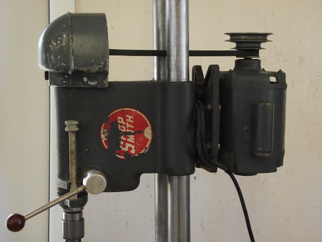

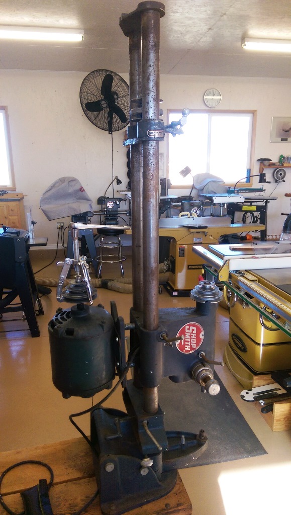

This one will be my permanent dedicated drill press. The 10ER drill press I have now is actually a demo machine. It has the decal on the back side of the head stock. It has not been restored and when it is it will be a display machine with a 4E jointer and a full set of the MK V SPT adapters for the 10ER.

The demo machines that Magna used had either a decal or the SS logo plate with out a S/N on the back side of the head stock. That way customers could see the brand. My understanding is that the demo machines Montgomery Wards used had the decal on the back of the head stock. That is what I have and I want to preserve it.ERLover wrote:What do you mean a "Demo Machine"? Restore and sell? Which I dont have problem with, they will go to good user homes. Just curious?
