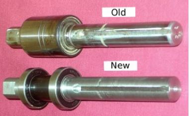

I asked because that is the second time in recent posts that they have been mentioned as inadequate. Curious if smaller than current or MVII idler shaft bearing pairs.

Are these not the same bearings as those in a Mark V with the new idler shaft/eccentric?

JPG wrote:I asked because that is the second time in recent posts that they have been mentioned as inadequate. Curious if smaller than current or MVII idler shaft bearing pairs.
I will post a picture later today. My contention is that this is a shaft that will turn at 16000 RPM when the quill is turning at 10000. Ironically, I have not had to disassemble the bearings on the Mark V or VII as they are still in good shape. That kind of speed needs a solid bearing set. There is going to be some lateral loads because of the inaccurate method of "balancing the sound" when setting up the shaft in question. I have seen better bearings in dot matrix printers.
Just seems under designed. But what do I know .... :)

Re: For those keeping score ...
I may be wrong but I am under the impression that the idler shaft bearings were upgraded on the new Mark V idler shaft in anticipation of the Mark 7. The difference between the shaft assembly for the Mark V and that for the Mark 7 is that the Mark 7 shaft is "shorter to accommodate the new pulley (without a sheave).
Upgraded Idler Shaft
