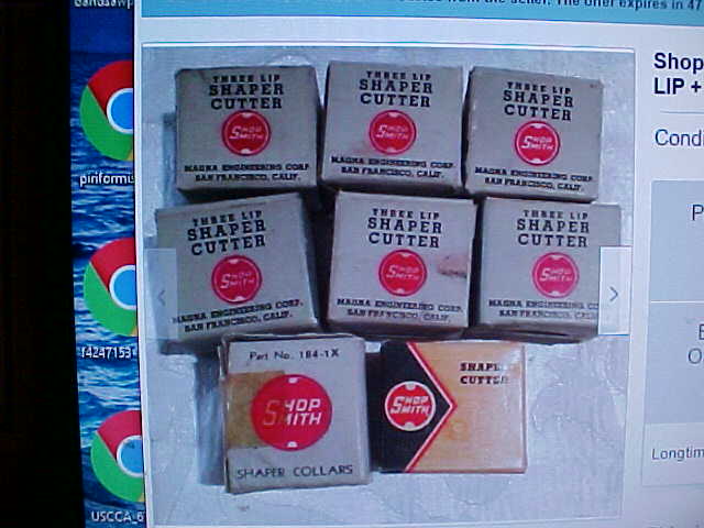

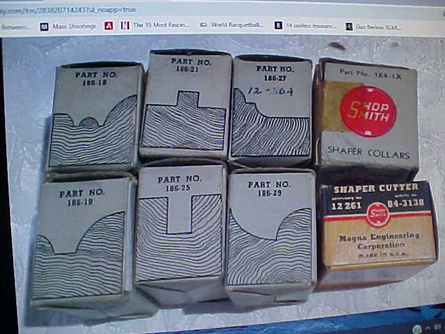

I don't see anything on the Shopsmith website that would lead me to believe there are restrictions that would apply regarding the selection of a particular shaper. Am I correct? Will any shaper work with any model Mark V 500, 510, 520 etc? Yes, I am a novice and eager to learn. Thanks
- MVC-111S.JPG (38.81 KiB) Viewed 9608 times
- MVC-112S.JPG (42.47 KiB) Viewed 9608 times

Certainly any shaper cutter that is Shopsmith or Magna branded would work. Others may or may not fit a Shopsmith.

I think it is safe to say that if a cutter has a 1/2" bore then it is probably compatible with any Shopsmith. I don't know of any exceptions but check to see the max diameter of the cutter is compatible with the diameter of the shaper insert.

I agree with what the others have said. The 7 shapers in the gray boxes are from before November 1951 when the part numbers changed made for the Model 10's. The other was from 1955 before the addition of Magna Power Tool Corporation as the second division of Magna but later than November 1951. The shapers remain essentially the same today as those made back then. The most important thing is are they sharp?
