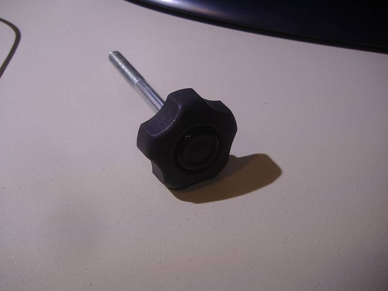

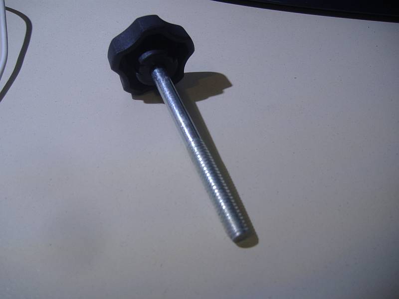

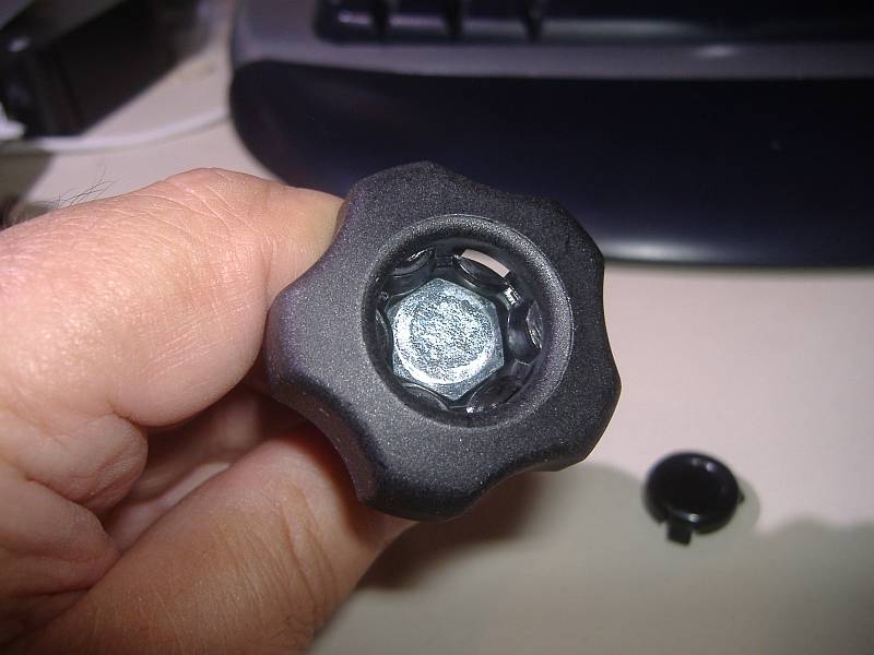

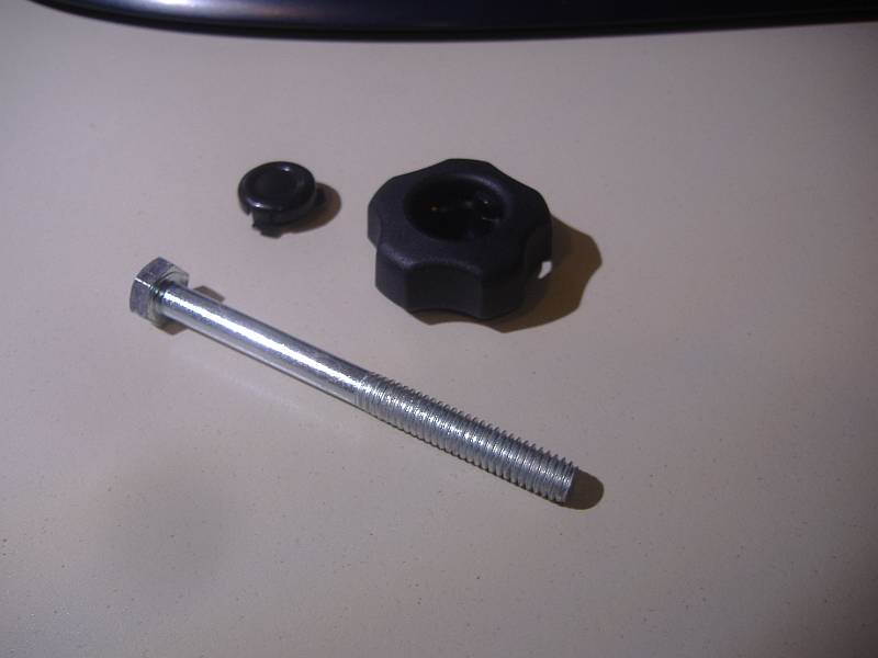

When mounting the stand to the shopsmith I have used a 5/16 -18 bolt, my in-stock size was 3-1/2" while shorter might have been better I used what I have already spent money on.
Those nuts are just hand tightened so no need for a wrench, but it could be a better situation. There are various names for these items but what they are is a plastic knob that fits the bolt head thus making them threaded knob. They come in various sizes and various forms. The ones pictured I got at a surplus store for $.35 ea.
The rest of the information can be seen in the following pictures.
[ATTACH]18459[/ATTACH]
[ATTACH]18460[/ATTACH]
[ATTACH]18461[/ATTACH]
[ATTACH]18462[/ATTACH]

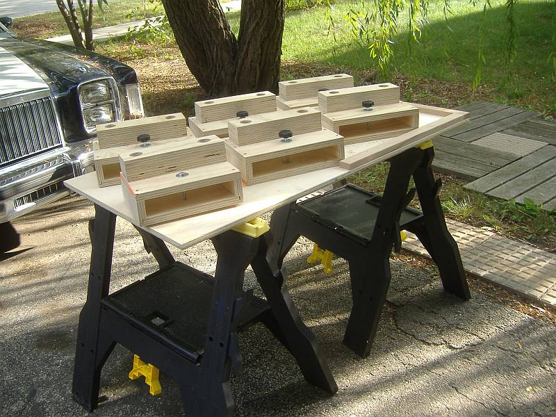

I was just downloading the images off my camera and I found this "last" picture of the set. I have 5 larger ones and 1 smaller one finished, thus concluding this project.
[ATTACH]18534[/ATTACH]
