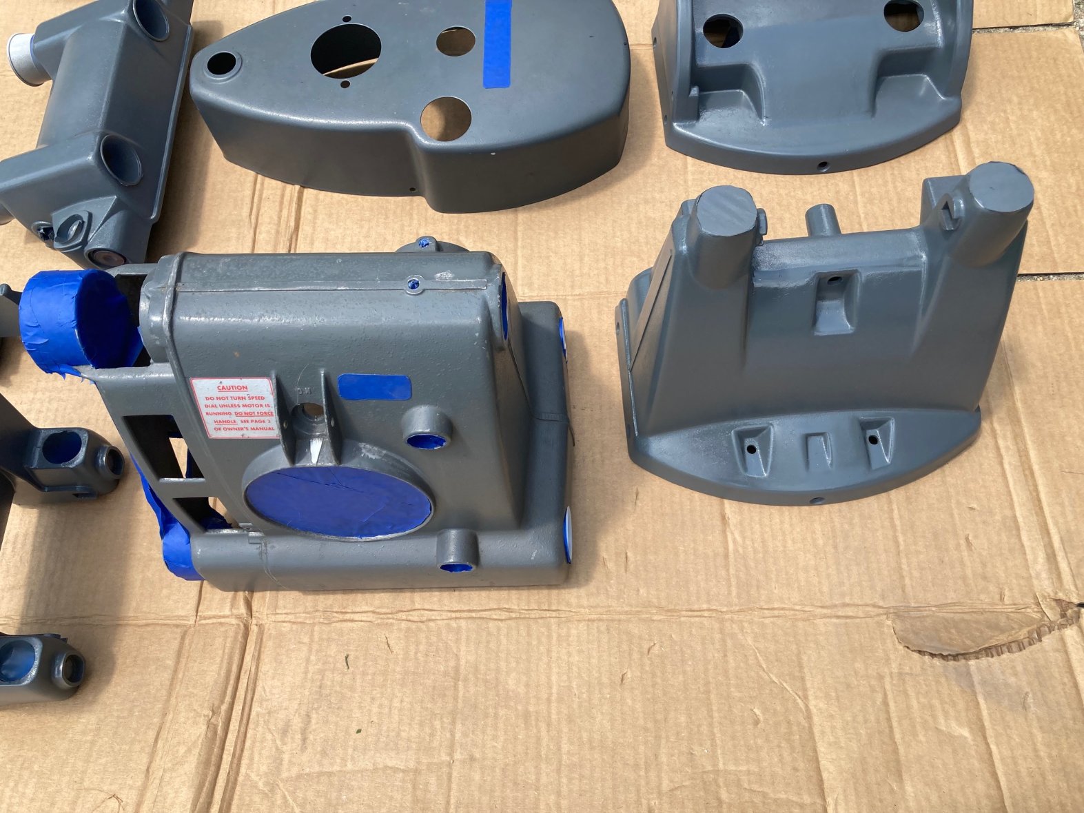

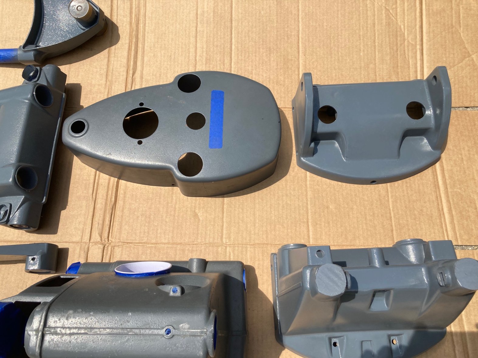

chapmanruss wrote: Mon Sep 02, 2024 11:49 am I have used the Shopsmith touch-up paint on my gray Shopsmith restorations as mentioned previously in this topic. I agree about the gloss level but find it does blend in especially over time. Some have been simple touch ups while others have been painting complete parts. I have noticed slight variances depending on the metal being painted and even the surface finish. Just my 2 cents.
VonZipper,
Great work on your restoration and I look forward to seeing it finished.

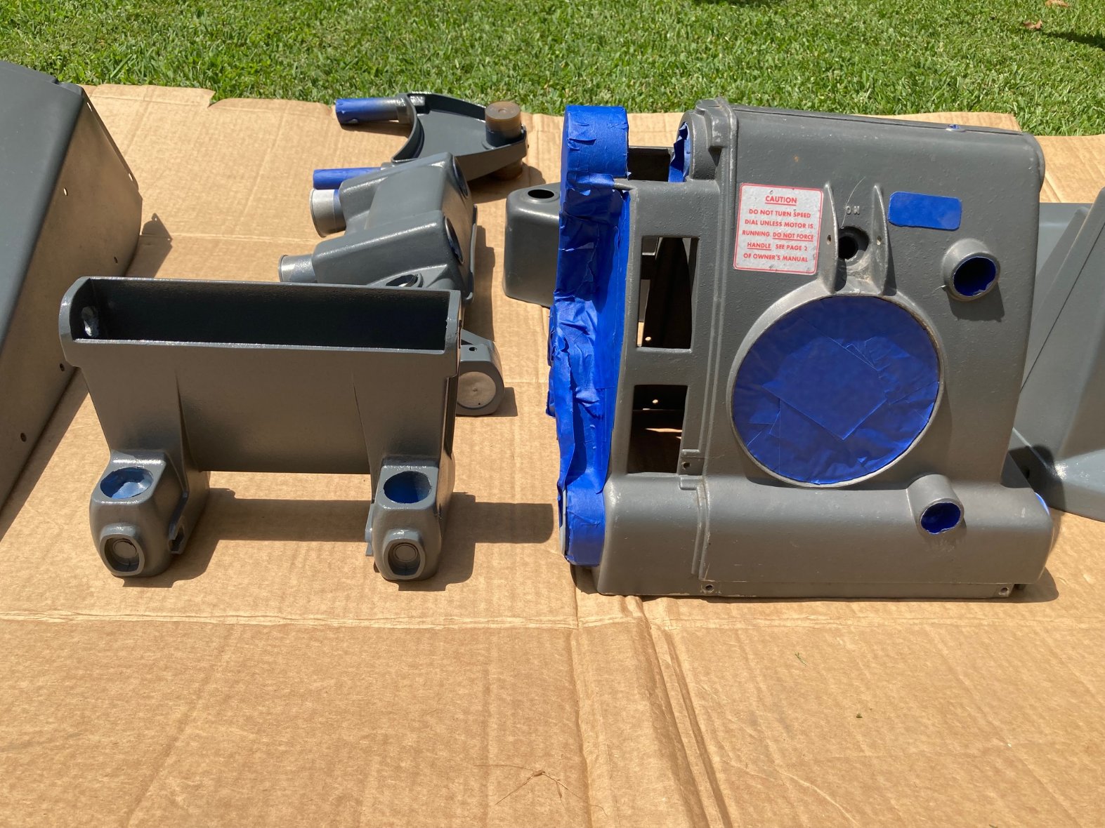

Russ, Thanks for the continued encouragement on this project. I'm doing the best I can: It's certainly not going to be showroom perfect but does look a little better! than when I started, I hope! I've seen the work you've done on your earlier restorations and I do appreciate your feedback on my restoration attempt!
Here's a couple photos of the recently painted parts next to the original factory paint job on the belt cover and headstock housing. The level of gloss does seem to vary with from part to part and even on the same part. That may my fault due to variations in paint coverage on my part.

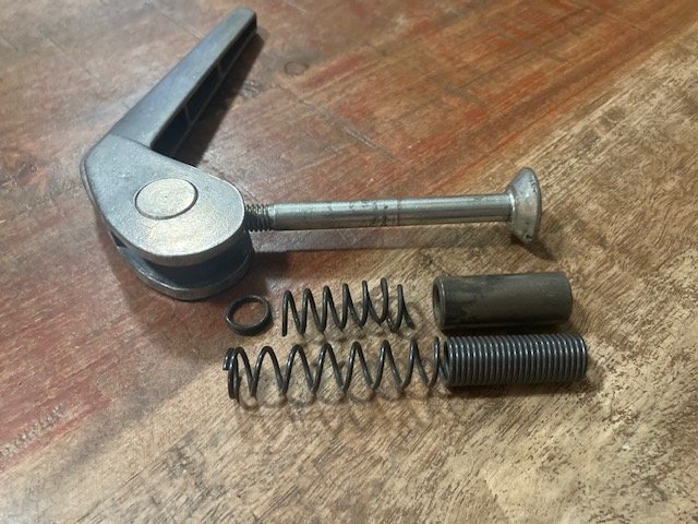

chapmanruss wrote: Thu Aug 29, 2024 1:02 pm That spring is not right. It looks like there are enough coils there to make 3 springs. You should contact Customer Service to get that corrected. Shopsmith should send you a correct spring. Fortunately, you can continue on the restoration as that spring can easily be put in place later.
Well, I got a response from Shopsmith about the latch spring and I was surprised by their answer. They said that what they sent me was, in fact, the correct spring. Apparently, the spring has been redesigned to eliminate the spacer in that assembly. The e-mail message isn't written very well (a sentence fragment, no periods and only commas!) Anyway, here's the exact message that I received from them this morning:
"The correct spring
The length of coils are equal to the broken spring
The stacked coils are a replacement for the spacer you have on the locking bolt, under the head of this bolt
To use this new spring, remove the old spacer then slide on the spring with the stacked coils in place of the spacer
Then reassemble the base lock normally"

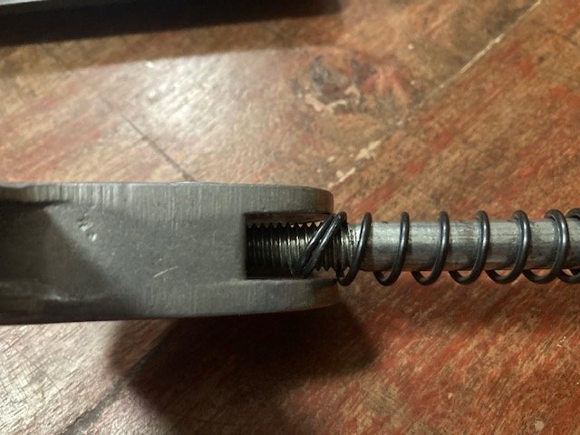

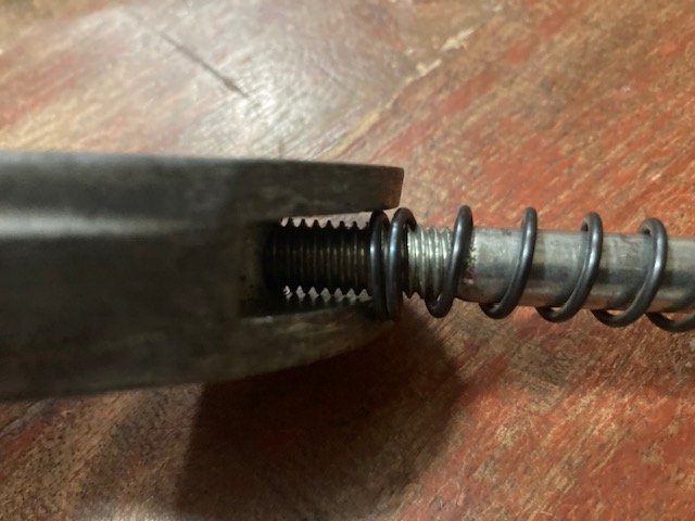

Updated Spring Update:
The spring design, on its own, doesn't seem to work well with the latch assembly. I must be missing something. Maybe it's designed to work with a washer or, perhaps, a redesigned latch handle? As you can see in the second and third pictures below, the spring, by itself, gets jammed in between the ears of the handle part. Surely, it must be designed to work with a washer to keep the spring from be tangled and distorted between the handle's ears. It wouldn't take long at all for the hardened spring to damage the soft aluminum handle and or distort the spring itself. I'll send customer service another e-mail to point out what I'm seeing and see what they say.

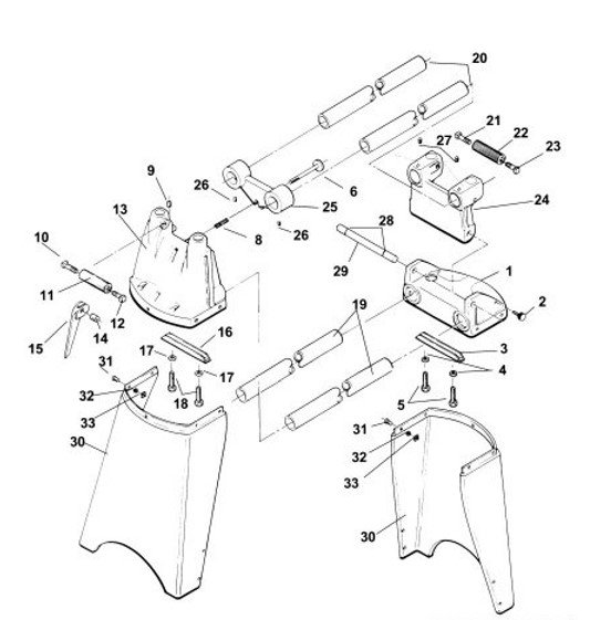

When looking at the current Bench Diagram (below) and parts lists it no longer shows a spacer and doesn't show a washer as you suggest either. By the way the lack of available parts currently is concerning too.
_
BENCH SERVICE PARTS.jpg (42.32 KiB) Viewed 1963 times
The diagram above is the same as the one in my 1999 Mark V 520 Manual. I have never had the Lock Assembly out of the Headrest on that 2001 Mark V or the 2006 Mark V.
How does it fit when actually installed in the Headrest? I would have to go out to the shop to check myself but how large is the hole in the Headrest the rod goes through? I may have to go out to the shop and look today.
Posts: 4533
Re: Dad's 1982 Shopsmith Mark V Repair/Restoration Project
VonZipper,
I did go out to the shop and looked. That spring without the separate spacer has been in use at least prior to 2001 when my Mark V was made. The hole in the Headrest is small enough so no need for a washer. I looked at the 1957 Mark 5 Greenie I have which is mostly disassembled awaiting restoration and it has the regular spring yours had and the spacer. If I would have looked at the Goldie I have waiting for restoration it should be the same unless someone has replaced a broken spring with the current one. As I recall the previous two Greenies and the Goldie I restored had the original spring and spacer. So did the 1982 Mark V I restored.
The tight coil section goes against the "head" end of the Shaft replacing the spacer's position and the spring part against the hole in the Headrest.

VonZipper
Posts: 65
Joined: Wed Aug 14, 2024 7:05 pm
Location: Baton Rouge, LA
Post by VonZipper »
Russ, Thanks for the help. It does work when installed the headrest. I was thinking the spring actually was in contact with the ears of the handle but those two pieces are separated by the body of the headrest when assembled. Duh, not sure how I missed that small detail! Not sure why I'm making it so difficult!

VonZipper wrote: Tue Sep 03, 2024 3:14 pm Russ, I have it completely disassembled for painting right now so I can't check for final fit right now. So, do I have the spring installed the wrong way around? I switched the direction of the spring in the picture below. Is it right or wrong now?
Personally, I think I like the old set up with steel spacer better. I may just get the one I saw on ebay: I think it was only $5.
