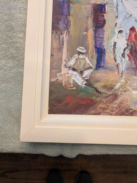

Here's the frame I'm working on currently.
Heres a closeup of the routed edge .
As the picture is very thick (1" iir) I am stacking a near 1" thick base frame with simple 45 degree miters. On top of this will be attached my routed "pretty edge" which extends and overlaps the painting itself a little. The pretty piece needs a minor recess to accommodate the painting thickness.

That is a nicely shaped piece of molding. Is it white pine or sugar pine? I would be interested in hearing what the sequence of operations was that you went through to get that shape. Hope you will also post some photos of the end result so we can see how the molding is finished.

Thanks for being interested Ed !
I don't know what type of wood, it was a 2x4 I had in my attic for 2 years. Some kind of pine from HomeDepot.
To make the decorative edge is pretty easy.
I made 2 passes on the tablesaw at the blade width and 3/4 depth (non thru cut). This skimmed the 2 edges creating a tongue.
Then I used a 1/2 Whiteside Cove Bit #1804 on the narrowed edge with an offset to produce a 1/8" step.
I probably should sketch this.

Ahh...I see it now. The two "skim" cuts with the board on edge is what I needed to have pointed out. Thanks!bainin wrote: ↑Fri Jul 11, 2025 6:27 pm

It needs a bit more sanding in the corners, but overall it assembled nicely.
Wife likes the raw wood look..so I wont be staining/polyu until a later date , if ever.
b
