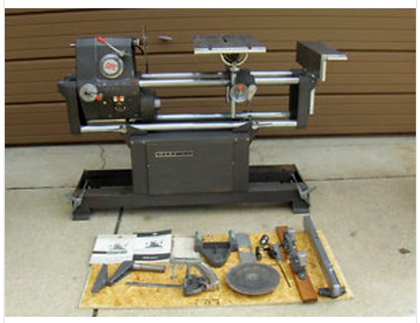

I picked up a Mark VII Sunday and will be refurbing it and will post pix etc as it goes. I like MickyD's index at the top of his journey(s) and will do the same here. I will split it into different threads as each major area is undertaken(so as to not create a humongous thread).
A few words about how I intend for this 'collection' to be used. One can begin from this thread and link to each of the 'sub' threads. Clicking on the 'return' arrow will bring you back to this 'top' thread. Using the 'close tab' function avoids the creation of a bunch of extra tabs. The link to this thread at the bottom of each 'sub' thread is intended to point here for those who encountered the 'sub' thread by other paths(search function etc.)
I am creating a second 'master' thread for the reassembly of the Mark VII.
https://forum.shopsmith.com/viewtopic.php?p=135519#post135519
Aluminum cam surprise = post #2

Paint is gray wrinkle.
There are several design details that were a precursor to the Mark V 505-520.
The table height crank and lock.
The carriage lock.
The shaper fence mounts to two holes in the main table.
As advertised on E-Bay
Paint chipped on headstock and slight rust spots on base.
First post will be showing a 'surprise'.

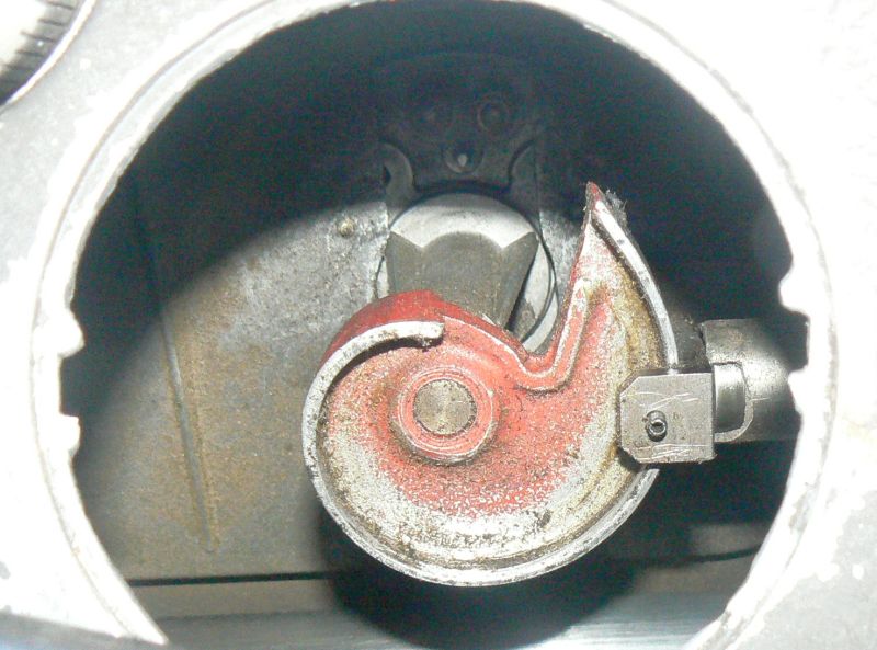

Surprise! One good, one not so
MVIIJOURNEY
When examining the condition of 'the cam' I discovered a surprise = it is cast aluminum. Paperwork indicates the cam was purchased in 1990 with a few other parts.
[ATTACH]18781[/ATTACH]
Also indicated in this pix is the other less desirable 'surprise'. The control sheave is not 'whole'. Hopefully JB Weld etc. will remedy that.
Not sure where the fuzzy wuzzy stuff came from nor if it indicates another problem.
